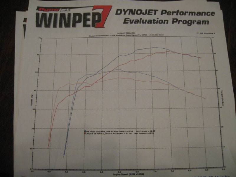

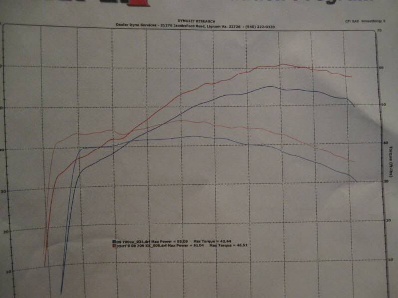

This is going to take me some time to put up all the dyno sheets, so please be patient. Daniel at HDD hooked me up with the first +3 tb and all you guys know about the spark plug, i also added a k&n filter. Here are the results of these 3 changes. Thanks Daniel for all your help and knowledge :tup: This is my sb with 11:1 cp piston and pump gas. 61.04rwhp/46.51tq
The bb maxed the stock fuel injector out. Daniel sent me a bigger injector( 600cc)with a PVC base map which had a perfect A/F until until 7000rpm and need just a little fuel added. This is the bb vs sb dyno sheet. Thanks to Bo, Daniel and Chris for all your help:tup: bb was 63.54hp/51.35

pump gas s/b= PCV or PC3 IS A MUST!!! Web 290 cam, Web Hardwelded Rockers, KB springs,+1 pp head, HDD bore tapered +3 tb, modded intake tube for bored tapered tb with K&N filter that fits around the intake sleeve in the air box. HDD clutch and HDD spark plug.
C12 race gas bb=PCV or PC3 IS A MUST!!! Web 290 cam, Web Hardwelded Rockers, KB springs,+1 pp head, HDD bore tapered +3 tb, modded intake tube for bored tapered tb with K&N filter that fits around the intake sleeve in the air box. HDD clutch and HDD spark plug, HDD 600cc blue fuel injector.

Why did he start the dyno runs at 4,000 rpm's??? :lmao:
Sorry i couldn't resist! ...Lord i appologize...
The pcv doesn't operate in 3 different stages like the dobeck does:lol: Lords and mods i do appologize! They are making 46.5 and 51.35 tq nothing to hide here lol.
