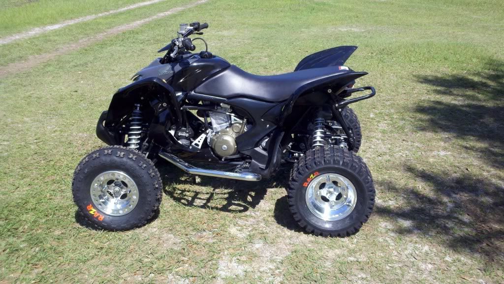

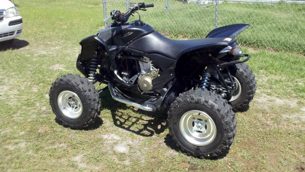

Here's a picture before the new Razrs and ITPs...
Here's the beauty after the new ones are put on....
I will say it's going to take a little getting used to...first gear winds out a bit quicker...I think it makes the bike look much better and the turning is definitely improved...

looks good, what size are they?
The fronts are 10x5 Polished ITP Baja wheels with Razr 21x7x10 tires and the back is 10x7 Polished ITP T-9 Pros with Razr 20x11x10 tires...It makes a lot of difference in the bike handling after riding it for a little bit and I can slide the back around a bit easier at my command... The bike is a bit lower, but so is the rear ground clearance under the A arms, but I'm not too worried about that...It's only like an inch...It is definitely wider in the back by about 2"...I took off the wheel scrapers only to find one was bent anyways...This wheel kit fits real nice and look great with the ITP flat lugs...
