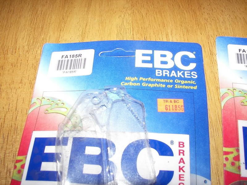

Here's the part number of the pads I used:
