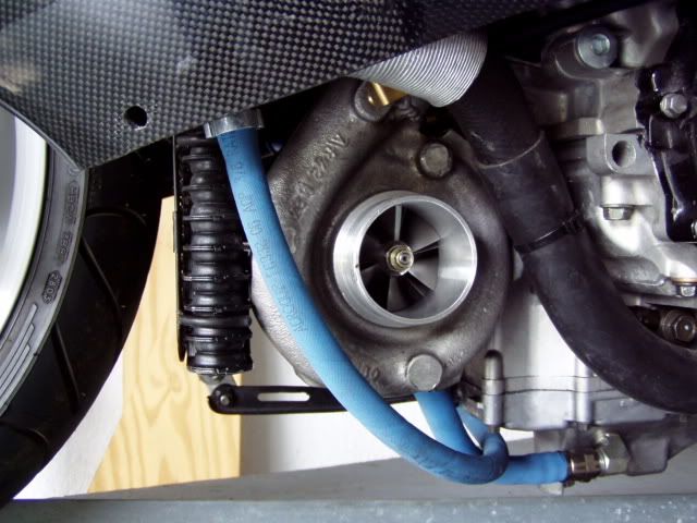

i just picked this up it will be included in my rebuild
definitely more simple ..but the xx only has 1.9 qts of oil ... i woulda thought the turbo would boil and varnish the oil... would be better overall for the motor i think to have a separate oil reservoir with its own pump... and if you use synthetics ... at 8-12/qt ..changing the oil and filter every time you run hard would be more expensive than making a small aluminum oil tank and having its own pump... not to mention the benefit of being able to pump oil and coolant through it after its shut down.i just thought about taping in to the feed and return lines with t junctions that seems to be the simplest way
Yep, thats were they are at on a sand dragger.That's a sweet ride! I hope that's not where the air filter stays, it won't take much sand getting through the filter to kill the turbo and motor.
