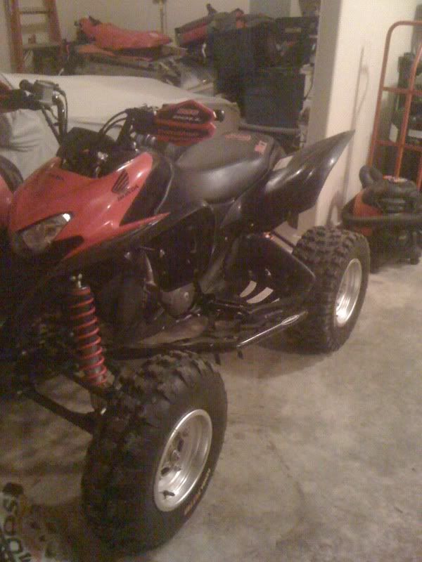

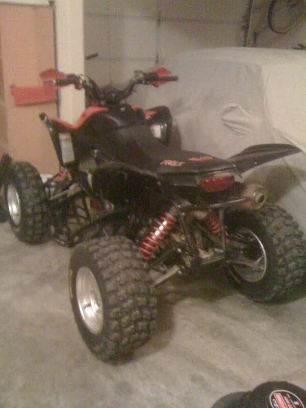

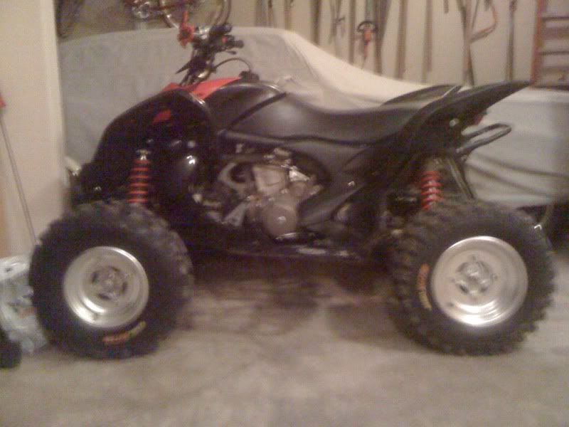

Oh and heres some crappy cell phone pics of the new tires:
