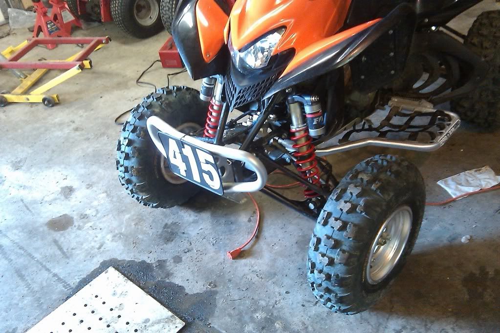

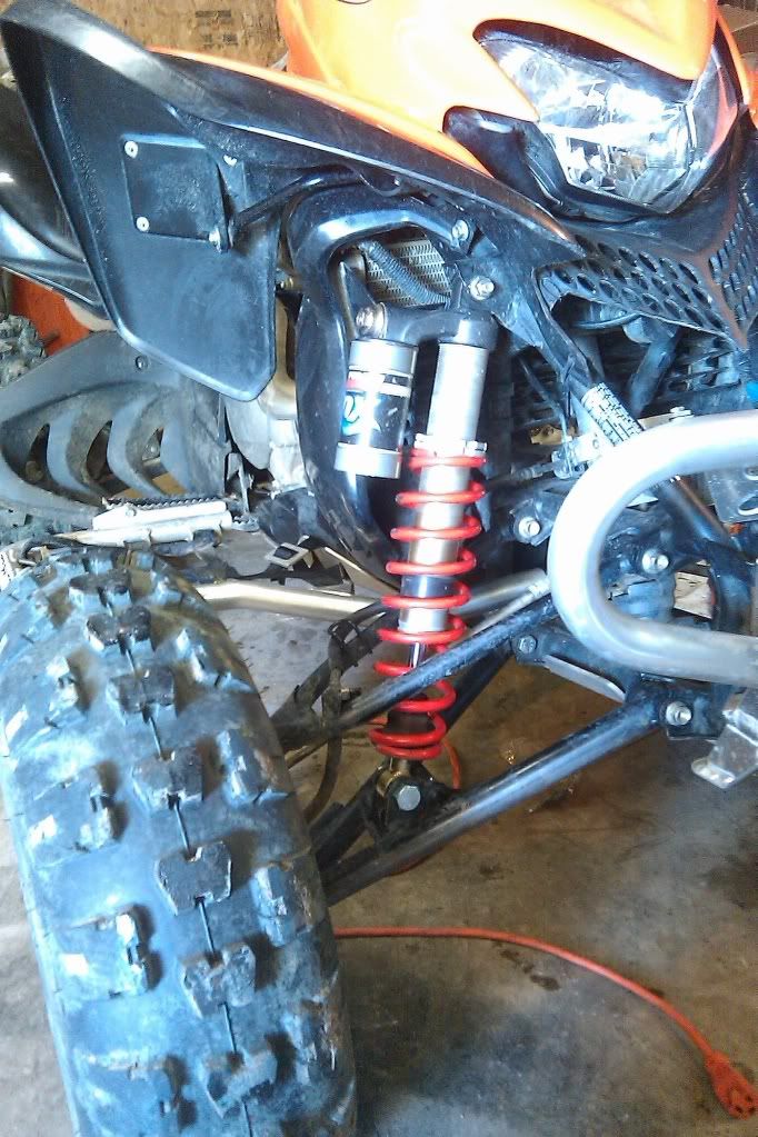

Got a couple pics uploaded. I drilled out the lower a-arms for a 14mm bolt. (stock is 10mm). Top is a really tight fit. Had to use a pry bar to spread the upper shock mounts and a rubber mallet to get them in far enough to get the bolt through.
291 Posts
I found out that there was a dowel missing in the lower shock eyelet.
Hopefully I can get a ride test on these soon.
