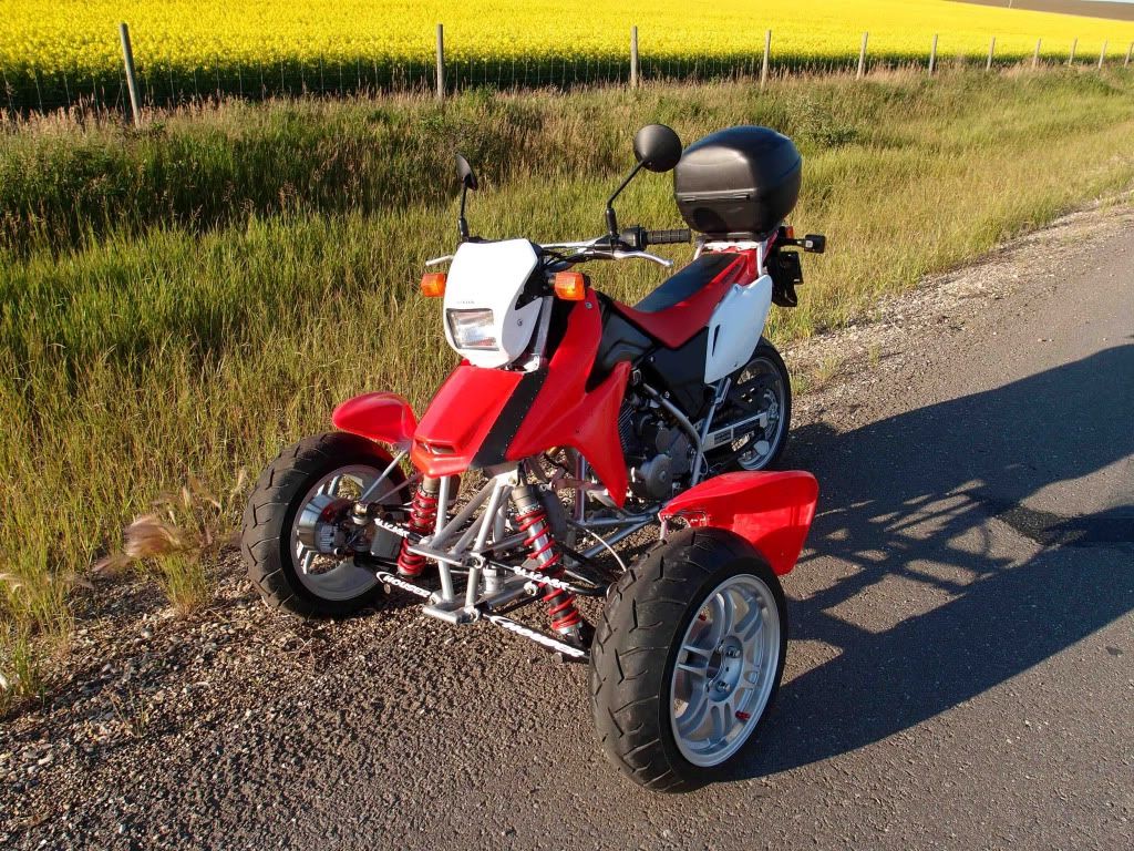

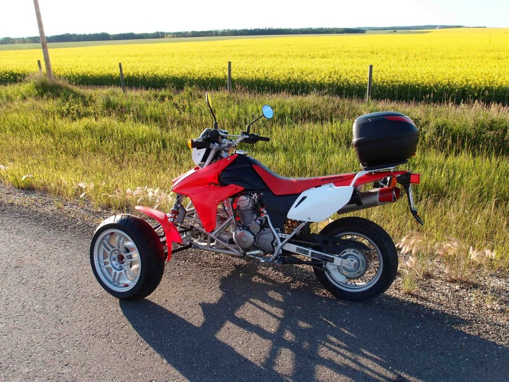

Hi guys, I built a little reverse trike out of Honda CRF230L and a 400ex, and I have a stabilizer bar from a 700XX that I want to install, but I would like to see a photo of how the OEM setup looks on the 700xx before I fab something to make it work.
I'll share my photos if somone can take a nice close up of how the 700XX sway bar installs...:D
thanks guys! :thanks:
