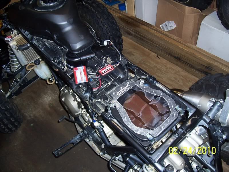

Just thought I'd share a few pics of some recent work I have done to my 700XX. Back around Christmas I got the FMF Q4 slip-on, and modified the airbox lid with an Outerwears cover. Then later with the tax return I got the PowerBomb headpipe, and the Autotune and Power Commander 5. This adds an O2 sensor to the header, and allows the fuel injection to automatically adjust. Also picked up a graphics kit from AMR racing, the pattern is Tribal Flames with Blue design on a Black background.

The instructions for the head pipe say to re-use the heat shield to protect the electronics. It comes with one larger clamp to go over the "bomb" chamber, and you re-use the other three hose clamps. You have to loosen the three Allen bolts in the shield so the mounts can swivel around to the contour of the new pipe. It takes some finessing, but it does fit!

Thanks for the compliments! I made the airbox lid myself, and the graphics are staying on great so far. The Autotune only works with the PC5.
