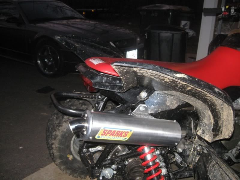

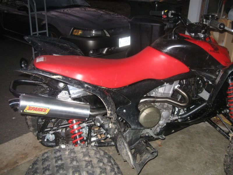

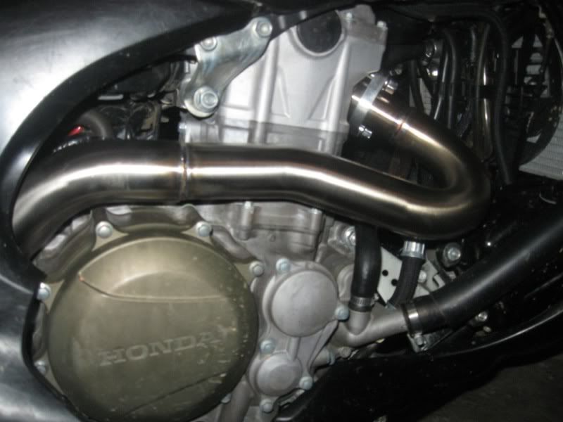

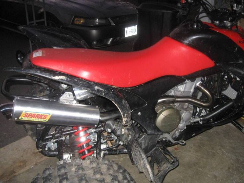

Just thought you guys would want to see the new X-6 Racing Sparks exhaust. I will do a full review of the exhaust this weekend. I will say it was harder to install than the Barkers, but not by much. Sparks will send you a free pc3 or pc5 map with purchase, i asked about the Dobeck and they laughed and said sorry lol. The sound clip can be found here.

Looks great, I cant wait to hear how well it performs.
looks like the flange is thicker that way it wont bend, the barkers looks thinner, my barkers is bent. that looks like a real good quality exhaust, also it looks like you dont have to drill out rivets to repack it either. sparks builds some fast honda engines too. nice i like it.

You can't see it, but there is no springs that hold the exhaust together. The screws to repack the exhaust is what i like alot. Believe it or not the Sparks is quieter also.

Hayden.. They sell different tips for it. Barker claims 103db and Sparks claims 101db. I have a open Barkers and the biggest tip for the Sparks. The Barkers is louder than the Sparks. I want to see the #s between the two lol.

Another thing you pointed out, is the Sparkes comes with 2 longer 450r exhaust head studs, that's how they made the flange thicker:hey: And also requires no exhaust gasket lol.

You might want to throw a washer on the top silencer mounting bolt. That looks a lot like the old Cobra mounting system and I have had those where the bolt pulled through the aluminum after a year or two of use. Thought it might save you some trouble down the road. That does look sweet.

Thanks for pointing that out, I put some dielectric grease on the bolt with a little locktite on the nut, but forgot the washer lol. Thanks guys for the compliments!
