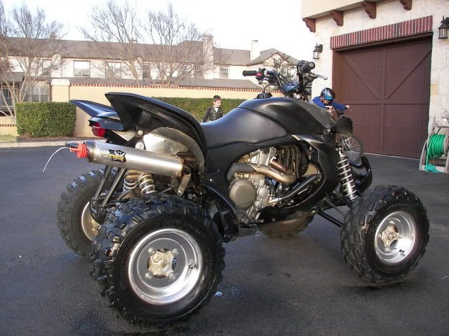

I bet it hasn't rained two inches in 6 months here...Looks good. I like the look with the front fender extensions removed, but mine, with the front spacers, slings way too much mud up on me. Better hang on tomorrow. Let us know how the quad feels uncorked......
Was there a purpose for trimming the fender?
Nah, I don't want to make it to where I can't ever go back or if I want to sell it later...I can't put it back on. With that said though, I have not plans or even the inkling of selling this any time in the near or distant future.aschuck said:If you keep it that way you have to cut off the tabs.
