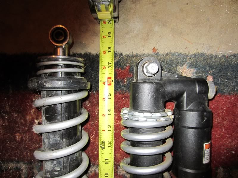

Here are a couple of pics showing the differance between the Raptor SE fronts vs the XX pogo sticks. I will post more pics and what's needed to get them mounted on the XX. The shocks have High-/Lo-speed compression, rebound and threaded preload adjustment, 9" of travel.

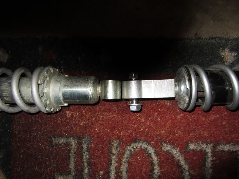

I had them setting here and figured why not see if they fit. The bottom mount will bolt right up, the top should be a easy fix. Best part is you can find them on all the raptor forums for 200-300.00 used.

The bottom mount look about the same width. This should be an easy upgrade.

Remember, the compressed length is just as important as the extended length. Since the Raptor shock looks to be around 2" shorter, the compressed length could be about the same, so the tire on the 700XX could travel up further, meaning the frame could hit the ground before the shock actually bottoms out. Just something else to look out for.
