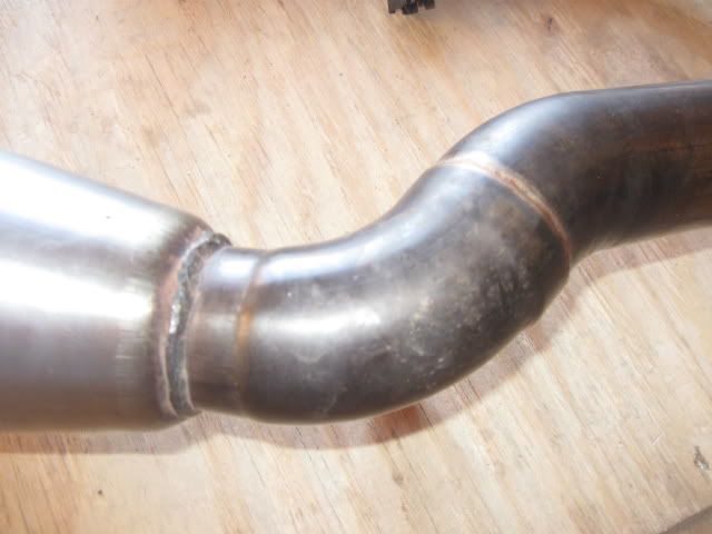

FMF PowerBomb Header & PowerCore4 Slip-on

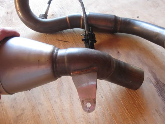

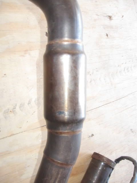

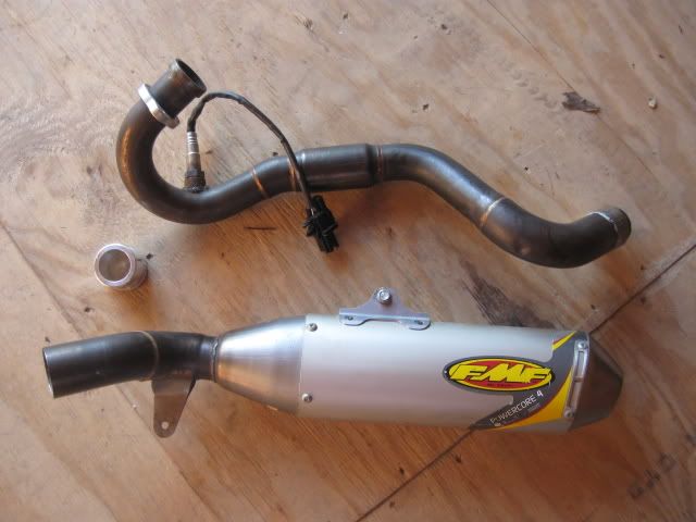

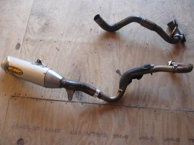

Here's an overall pic of the system. I personally installed the bung that was supplied with my PCV, FMF does no offer this as an option. The system does include a bushing to use the slip-on with stock header.
The next three are pics of the welds, They are all uniform and clean.

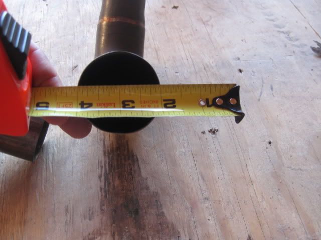

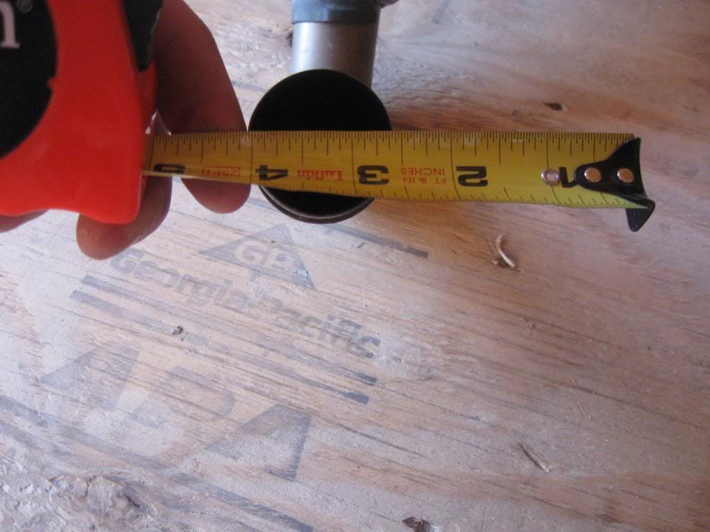

Stock header 1 3/8"
PowerBomb Header 1 7/8"
Picture with bushing installed to use slipon with a stock header
System installed
Overview:
Fitment was spot with no modifications needed. All hardware is supplied and the only thing you will need is black RTV. I've owned both the Q4 and PowerCore4, The Q4 is noticablely quieter, The PowerCore4 is a bit louder but totally manageable. Both have removeable spark arrestor's. I never removed mine as I do not like loud exhaust. I've but over 60 hrs of ride time on my PowerCore with my built motor and have not had any issues. The design of the slip-on is a plus also because the mid pipe is a full 2" compared to the stock 1 3/8" some others use.
