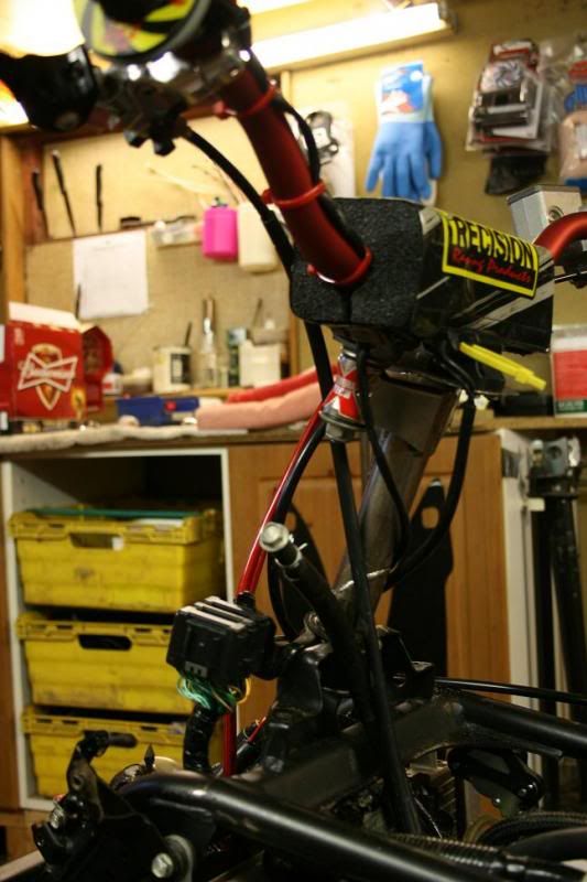

Bought some new Renthal Fatbars #604. Wanted to try something taller than the Easton mid CR bars , I got from Ed. Hated them big time but found a way to gain a few inches on a stock clutch cable by rerouter it. Instead of the usual route , I did the Husaberg route and followed the return pipe from the pump. Here's a pic.
Someone said once , a mistake is not a mistake , if you learn something from it.
The pic is Renthal 604 Fatbar on a +2" teixeira stem and Precision shock n vibe clamps.

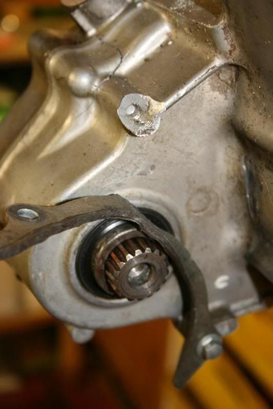

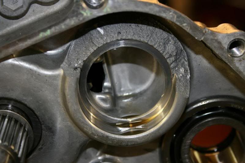

Got the motor out finally. All my fault on this one.
This is damage done with running the chain too tight and a stiff rear end.
There's me thinkin the chain fell off. lol.

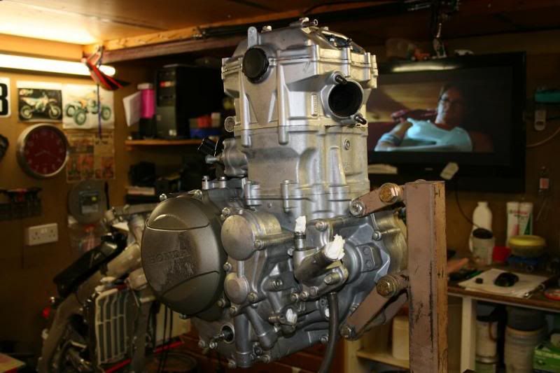

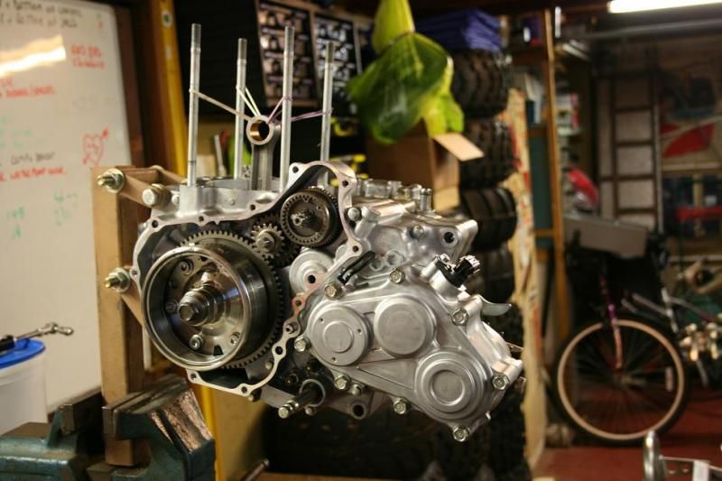

Been a long time but still having problems and still need a second transmission.
Started rebuilding the motor after the last mishap. Fitted the +3mm stroker crank .
