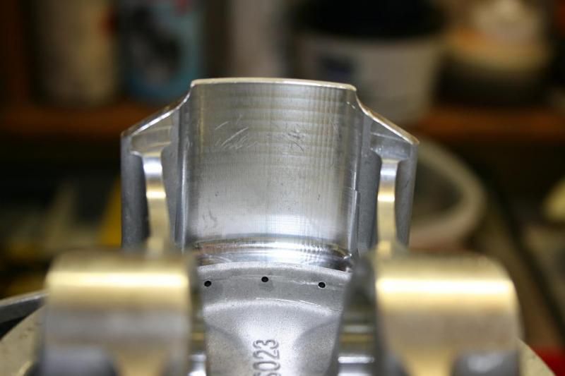

Racing next Sunday and then found out , I had no OEM head or base gaskets. The only thing to do is fit a Cylinder Works big bore kit , I got way back.
Took it to 754cc, fitted fine snugged everything up but not torquing the head . Thought I'd fit the cam and the motor locked up . Just before BDC.
Little looking and the piston front skirt hit the balancer. Only thing I could think of is Dremeling the front skirt to fit.
So this !
Turned into this !
It only has to last about 5 hours then I can put it all right.

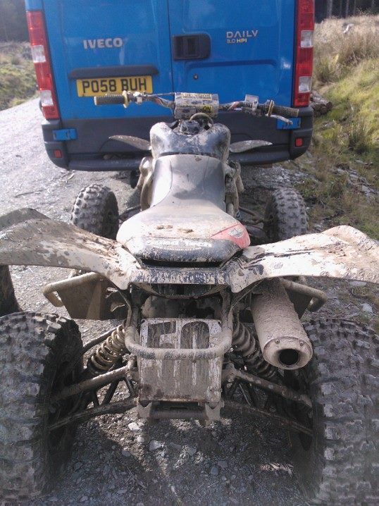

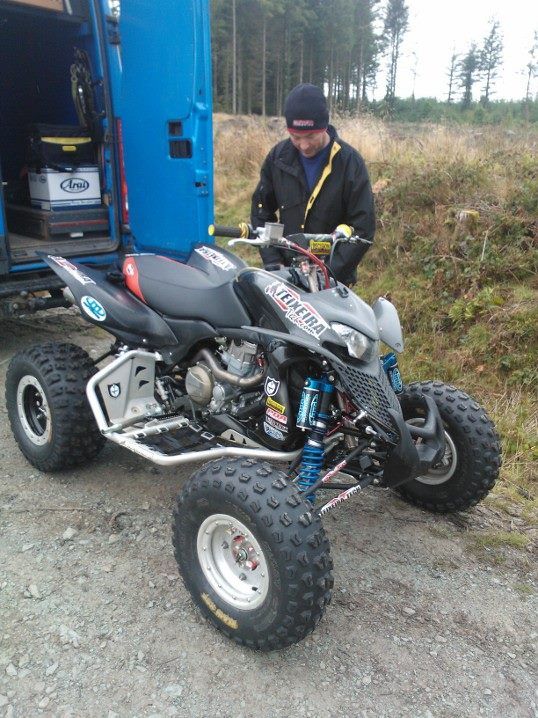

Got Big Rex finished and went and raced a Winter series enduro, The track was more like the GNCC tracks in the US and I managed 6 laps in 2,5 hours. The track was hard but great. Did have one moment where the 700xx did a complete sideflip and landed upside down and on the stem. Another email to Ed Teixeira for some more parts.lol.
Here's a few pics

Bent stem but finished 4th overall and 1st clubman.
The clamps were rubbing the tank.lol.

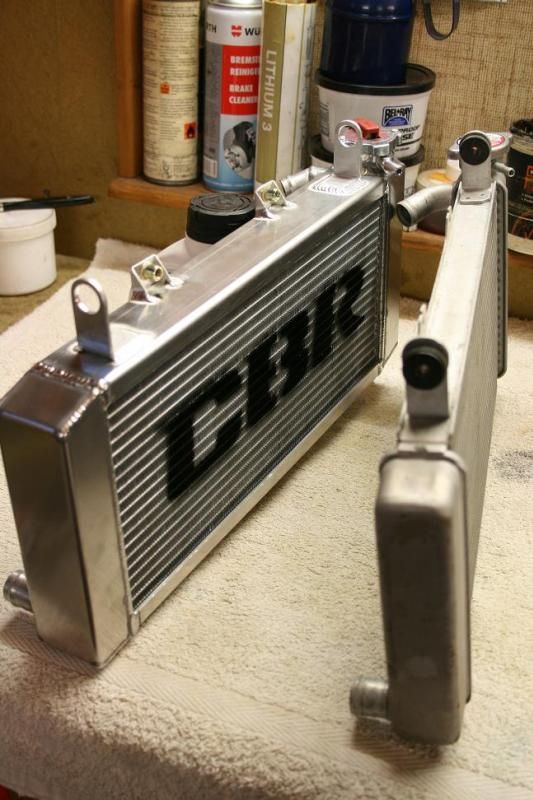

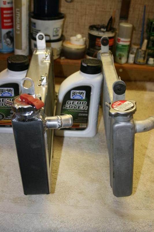

Just got a new radiator from Duncan Racing. Been looking for a bigger rad for sometime and found one built by CBR. A tad expensive to the Ebay ones but good welds and build quality is top notch.
CBR vs stock width wise.
