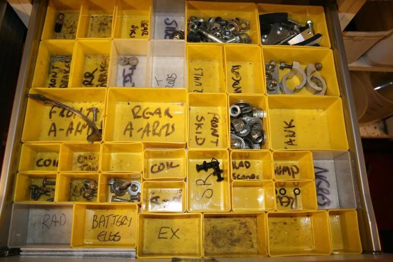

First off , As I strip the xx almost after every race , I found this system to help me out. You would be surprised to find how many bolts there are just on the plastics.
There basically tote trays fitted into kitchen unit drawers.

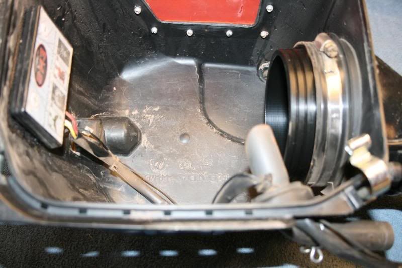

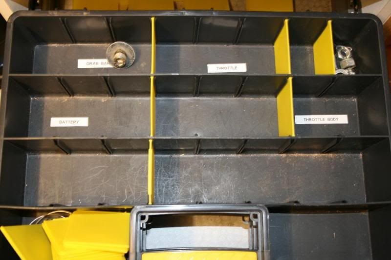

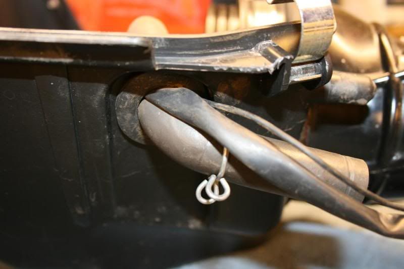

How to fit a EHS or Dobeck programmer in to the airbox without cutting the airbox.
The knack to doing this is remove the breather pipe , remove the grommet. Feed the EHS/Dobeck plugs through the grommet then refit the grommet to the airbox. Put alittle lube on the breathe hose and insert the hose into the grommet. You need about 12" of cable through the grommet to fit , where I placed it. If you use a EHS Racing airbox lid then you still have a sealed airbox. If you don'y use a lid then this post was a complete waste of time and energy.lol.

These are pics to go with post one. Being organised.

Simples !

very interesting and very organized is all i can say. when i tear mine down i would never remember where everything went without labeling them.

Theres alot of nuts, bolts and thingys when you strip the xx down. Took me 12 months to come up with this system and it helps when you are in a rush. Like having 4 days to rebuild/setup the xx for Beach Cross from oval racing .lol. Nothing like a challange.
