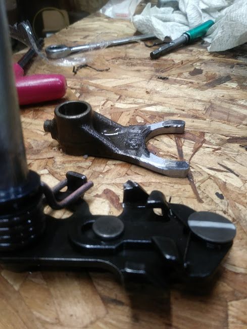

found some ware on the center shift fork . ordered a new one . still have not found a good reason for it jumping a gear, 3 to 5 . cylinder looks like new but there is some ware on the center cam lobe as well the rocker . it will go off the web for resurfacing

found out why I'm having shifting problems

see the beat up silver ware mark there is also some ware on the fork

i used a welder to build up the worn spot on the shifter shaft .t hen ground it . the part it about $70
what i am wondering is the weld harder then it was before
