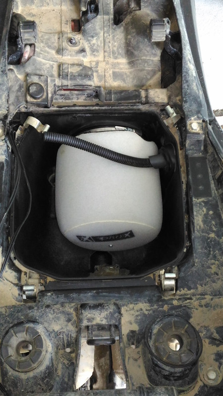

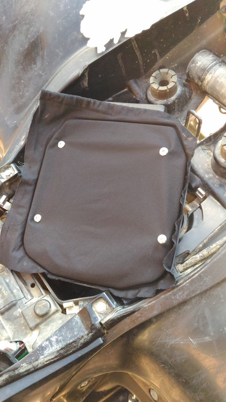

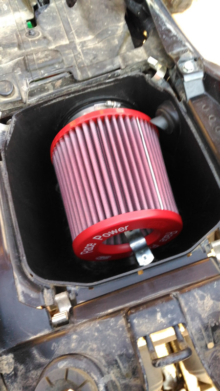

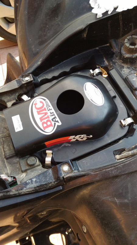

here photos:

Are you not running a pre filter over that filter? With the opening in the air box lid, lots of dirt will get in. At least if your terrain is similar to mine. Looks like you got it to fit the intake well. And I like the hole in the lid, but I might of went larger.
Never mind I see now in 2nd picture how it will filter all air, nice job!
Sent from my SAMSUNG-SM-G870A using Tapatalk
Thank you,
it's a prefilter,
very simple,
it was the bag, sent together with the helmet
and has an interesting porosity,
quite tight,
but a lot of air,
It allows to cross

new air filter + fuel controller applied !
