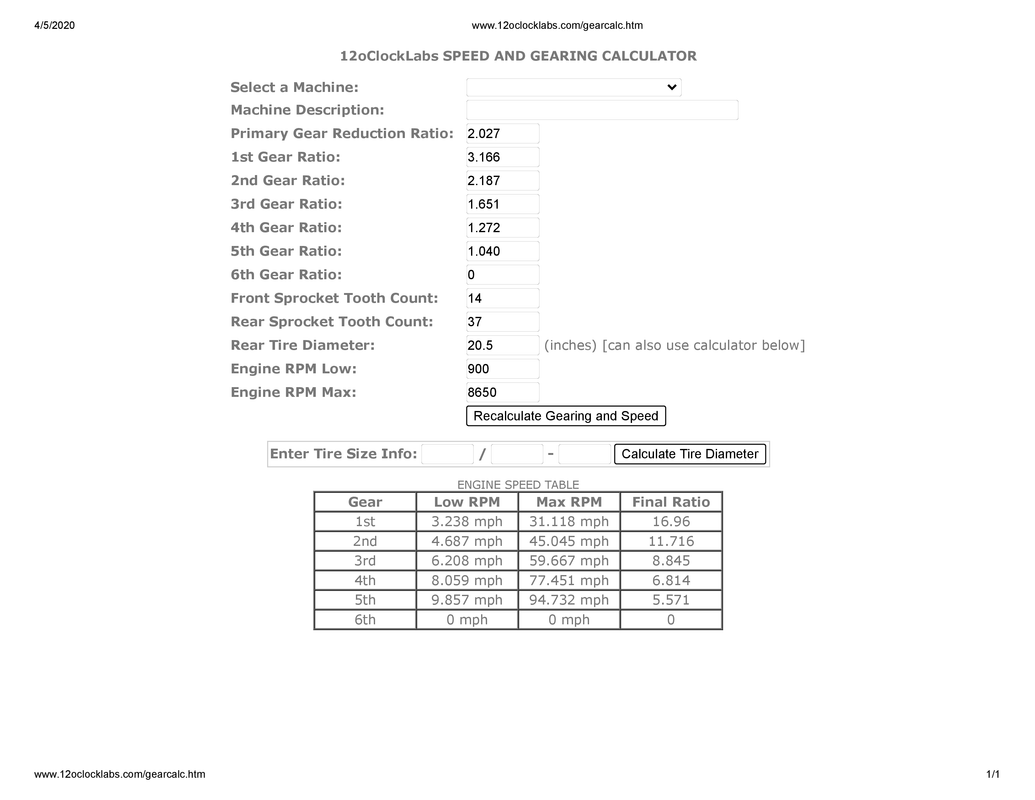

whats the high RPM set at ? 8000? 9000? went through the service manual did not find it .
i'm doing a speed sheet calculator

seems a bit fast
