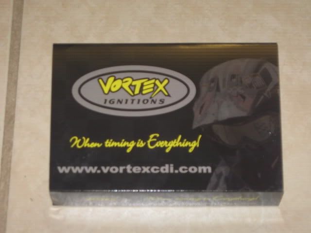

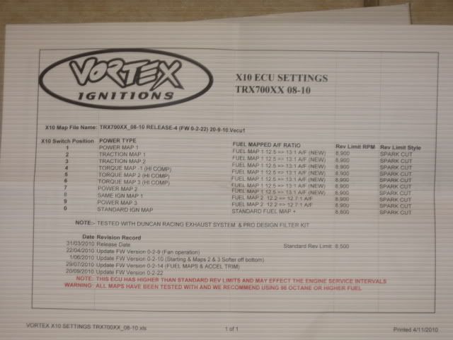

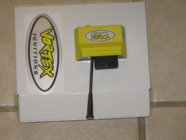

Gotta love getting new parts. Vortex ECU
One of a few parts that will be going on a new build in the next few months. I'll have a few new parts to showcase in the next week or so and will post up as I get them.

The maps can be manually adjusted +/- 12%, You can also build your own base maps as well. For most builds the supplied maps are more than adequate and can actually support cams and higher comp pistons as well. I'd spoke with them off and on over the past year and would have had one 8-9 months ago if I hadn't stepped away as I did for awhile.
The software is $250.00 and I will be ordering it Monday. If anyone else were to purchase a Vortex ECU I would be willing to ship the laptop with my software installed for $50.00 rental. I know it's kinda shitty to rent it but at the cost I'd need to recoup a few bucks. I downloaded the trial software and have spoken to a Canadian tuner that uses it and it well beyond PCIII software.
I know some will quack about the price of both the ECU and software but I'm sure in time it will decline. If you look at what you get with the ECU though it's not all that bad. You get a complete ECU, not a piggyback unit. Within this you can adjust rev limits, fuel and timing. At this time no one even makes a plug in module for the timing. Another plus is the user controls, You get the best of both worlds that you get with a PCIII and dobek. You can build custom maps and manually adjust them on the go which both others offer but not together. I could go on and on but I'll just answer questions the best I can, The Vortex may not be for everyone but I'm sold it's what I need to get the best out of what ever parts I put together.
