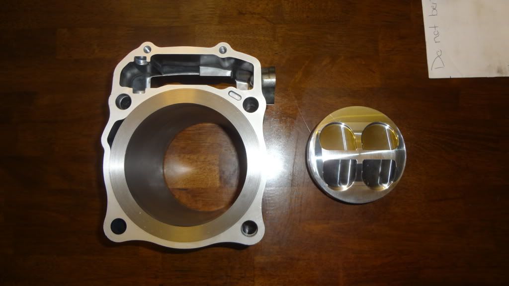

After a year of wait... I finally got it in hand. This one is 105mm, I didn't feel it was necessary to go all the way to 108mm yet. All I have left is to put it on the bench drill and knock out the water passage holes.

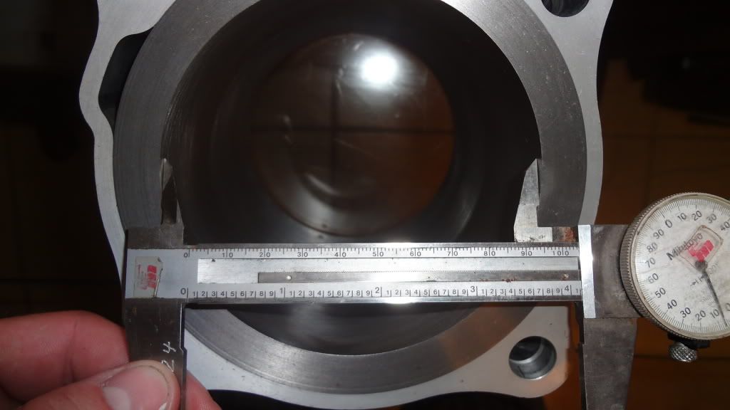

very nice, should hold a head gasket quite well!
how thick is the sleeve wall with the 104? u dont want too much metal there, holds a lot of heat and wont transfer as well as aluminum

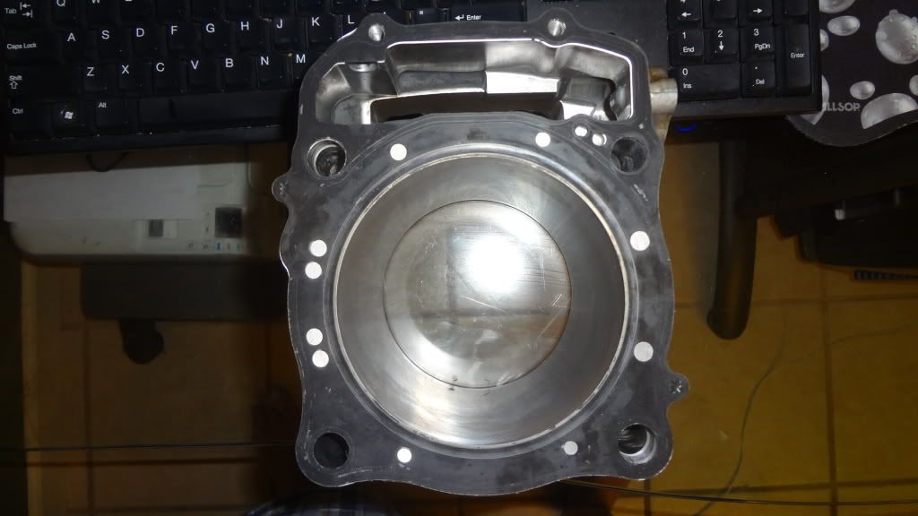

As you can see in the pic there is one area we couldn't fill, It's not going to compromise any strength or affect the head gasket seal. The gasket and head both cover it.
Traitor, It comes out to 727. Stock bore is actually 686cc, 41cc gain.
RednBlack, It'll be the strongest part on the bike. It started out as a solid 5/8" thick walled sleeve.
