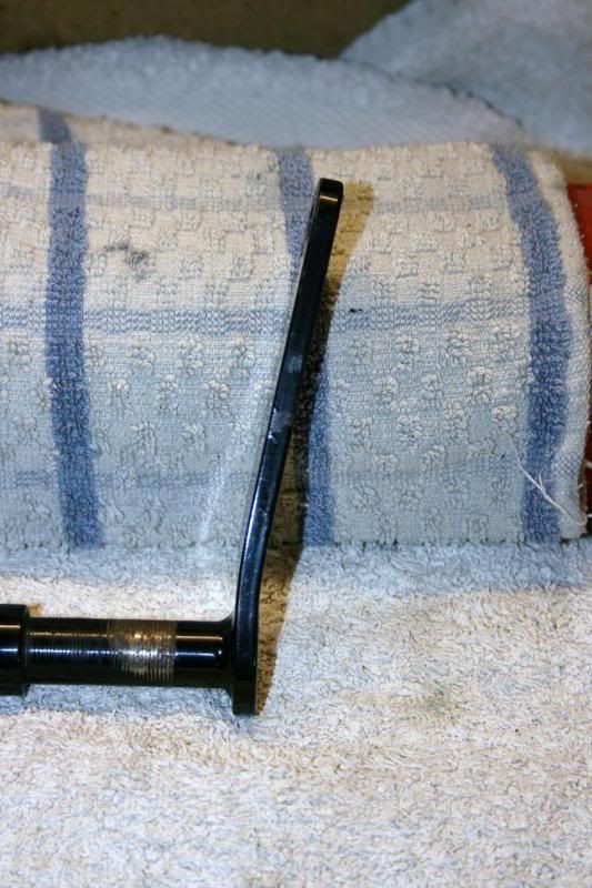

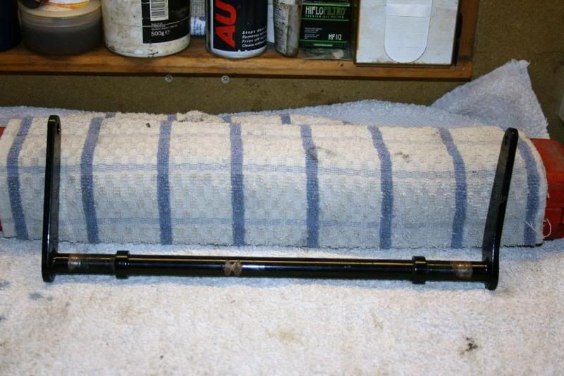

Been rebuilding the T-Rexx for the new season and was struggling to get the rear shock bolts out. Found this to be the problem. Anybody else's done this ?
Was going to straighten it and put it back on for next year.

Wow! I'm not so sure how you managed that, especially beach racing. I wonder if this could be part of the reason Kyle switch back to original design on the 11/16's bar or is that the 9/16's? On a side note, what caused the rub spot near the center of the bar " loose chain" ? I know the outside spots are from no or not enough lube on the bushings

It's a 11/16" bar and the wear marks are loose chain but within Honda's settings and not enough lube on the pivots. I think I know what caused it and probably should have used the stocker for beach racing but basically I think I ran the rear shocks too soft and overworked the swaybar. The chassis twists more in beach racing than say on a MX track also.
