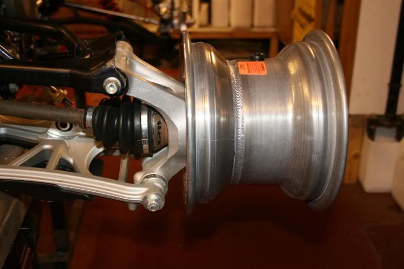

You can run 9" rims on the rear but even using modified 450r or 400ex hubs it's wide about 8" wider than stock front. I've run the 450r rear hubs for about 18 months. Only use the 700xx hubs for XC and Beachcross. This may change as I am growing to like the DWT 8x6 rim with a 3:3 offset. The perfect rim for the 450r hub mod.IMO.

baxter, you have a pic of the 450r hubs modded? i'm guessing that's what i did to my brothers...

This is a 3:3 rim on reworked 450r hubs.
I have a set 2:4 , 8x6 A5 rims. Going to try these with the TRX420 hubs.
